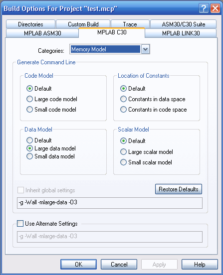

xxxxxx.o: Link Error: Could not allocate section .nbss, size = 64 bytes, attributes = bss near
Link Error: Could not allocate data memory
Link step failed.
If you're trying to compile source files in MPLAB (for debugging purposes) that compile fine in Matlab, but run into the error above, try enabling "Large data model" under Build Options -> Project -> MPLAB C30 -> Memory Model
Hope that helps!
